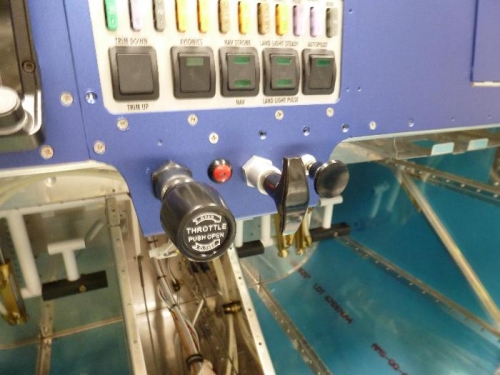

install choke in instrument panel
Manual 50-02 steps 2 & 3 secure throttle and choke cables into the instrument panel.
Manual 50-03 steps 2, 4, 5 clamp the throttle cable to the bottom of the instrument panel with cushion clamp.
Manuakl 50-04 step 1 and partial 2 run the cables through the firewall and clamp them to the engine mount standoff. Not tightened.
Ordered another cushion clamp for the choke cable because I used the proper one someplace else on the build.
throttle and choke installed
