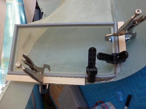

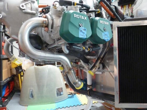

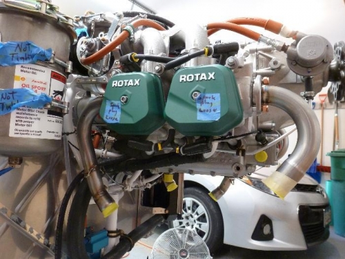

applied duct seals, install exhaust pipes
Manual 49-15 steps 3 & 4 - apply duct interface seals with clear Permatex #80050 RTV (-75 to 400F), clamp in place.
Manual 48-02 steps 1 - 3, install Cyl. #1 EX-00044A, Cyl. #2 EX-00044B exhaust pipes.
Manual 48-03 steps 1 & 2 - install Cyl. #3 EX-00044C, Cyl. #4 EX-00044D exhaust pipes.
Manual 49-15 step 5 - cut the corner of the duct seal with utility knife.
clamping seals on duct interface
left side exhaust tubes
right side exhaust tubes
