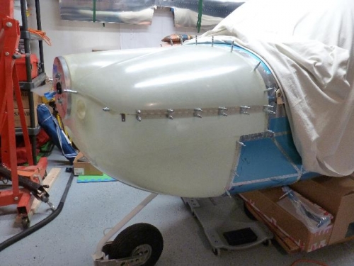

rivet hinges onto the cowlings
Manual 38-06 steps 9 - 11 partial started to rivet the top left. Had trouble riveting, switced to 3-3.5 rivets to keep them from bending out of shape, also used some 4-4 rivets after drilling them out. This worked much better.
lefdt side riveting
