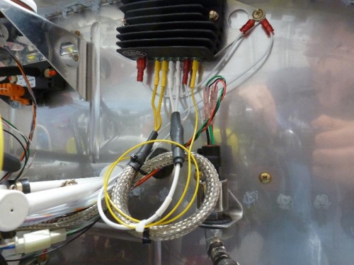

Manual 45A-04 and 46-19. Applied heat shrink to voltage regulator wires yellow generator, P204, 205,761. Attched the P204 and 205 wires per the 46-19. After consulting the electrical schematic, plus seeing reference to P-761 on page 5 of SL00034 on the voltage regulator I decided to attach P761 to the "C" termnal of the voltage regulator. Using an ohm meter I verified that P761 is connected to P156 when the Master Switch is turned on. The schematic also shows this.

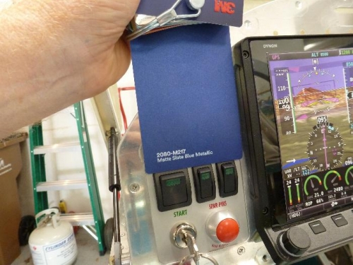

Decided to order 3M 2080-M217 Matte Slate Blue Metallic wrap to cover the instrument panel. I chose matte to avoid sun reflection form gloss wrap. This blue is a nice compliment to the blue in the upholstery.
