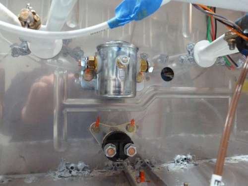

Manual 46-05 step 6 - torque the engine mount bolts to 29.5 ft./lbs. Unable to torque left rear bolt due to clearanve not adequate for allen wrench to fit properly. Taped it with note.
Manual 45A-02 - step 6 install master relay torque bolts to 70 in/lbs.

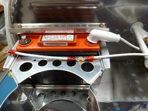

Manual 45A-03 steps 1-3, connect power cables to battery and chassis mount.
master relay
power wires
