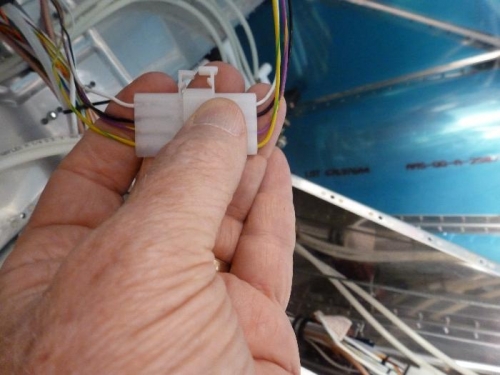

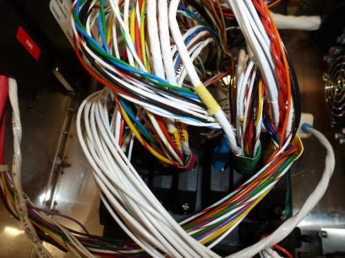

Brief Description:  Finish AP cutoff wiring, connect trim tab wiring
Manual 58-05 Finish step 4, insert the AP cutoff wires into connector. Had some difficulty getting the other wires out of the Molex connector but with an ordered tool and some minor modification I was able to get it.
Manual 44A-05 finish step 3 connect the two AP cutoff connectors.
31B-04 steps 2 - 4, tested the trim tab wires for the proper polarity of the "tab up" +V wire so they can be inserted into the correct "fuselage" connector locations. I used a 9V battery which ran the trim tab servo just fine. Servo was not installed but I watched which direction was happening and used that as my indication. Finished the "Fuselage" connector and installed onto the AV-50000A. Also looked up the electrical schematic so that I understand the connections. Everything is understood.
Auto pilot cutoff switch connector
stabilator trim wiring finished
