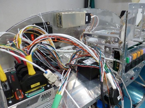

Manual 58-04 step 4, remove three wires from the WH-00031 25 pin d-sub to AV-50001.
Manual 58-05 steps 1, 3, partial 4 insert wires into WH-00105 and connect to EMS module.
Manual 58-06 steps 1 & 2, install and connect the two AP panels into the center bay.

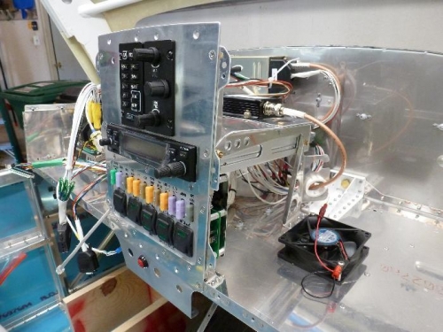

53-06 steps 1 & 2, mount Garmin Radio brackets.
53-08 steps 1 - 4, install and connect ADS-B module and bracket on top of Garmin brackets.
Manual 42G-03 steps 1,2,&4, Attach Garmin Radio mounting tray, cables and radio.

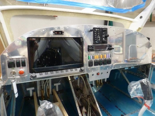

Manual 42M-08 steps 1 & 2, install AV-50002 ignition module in left instrument bracket and bay
Manual 42C-05 step 4, mount the Skyview panel in the left instrument bracket and bay.
Put right side bay with glove box back in.
wiring details, Garmin bkts in
AP panels and Garmin installed
Skyview mounted, panel done
