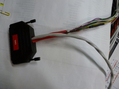

Brief Description:  wire up the CO monitor wires to EMS connector
SL-00010 connected the wires for the CO monitor to the EMS 47 pin connector. Connected grounds to pin 3 and 5, connected CO monitor signal to pin 10 (GP6), connected the SPO2 signal wire to pin 21 (GP10). Will need to finish the setup in the Dynon. Soldered the pins to the wires, did not have the proper crimp tool, worked well. Had to spiple into the wht/red wire from the EMS connector pin 18 for 5V. Soldered and heatshrink two layers.
