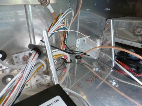

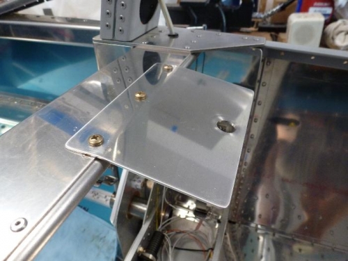

Manual Reference:  42F, 42G
Brief Description:  mount ELT antenna bracket, install stack angles
Manual 42F-03 steps 1,2, 4 - drill out three rivets and enlarge to #19, deburr. Used strong magnet to locate the rivnuts in the Mid Fuse Brace. Screwed in place drilled #4- holes, countersink and rivet in place. Mounted the antenna bracket.
Manual 42G-02 step 4 and partial step 5 and 6, rivet in place the left and right instrument stack angles, install grommets.
ELT antenna mount
ELT antenna mount
instrument stack brackets
