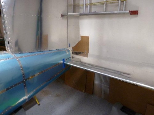

Manual 12-09 steps 3 -5, install stabilator. Kind of difficult to get lined up and insert the pivot bolts.

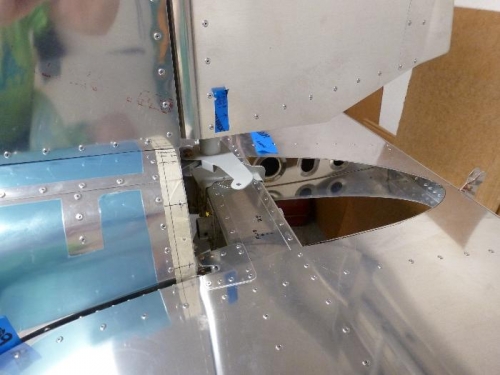

Install the fairing, drill holes on right side for proper alignment. Clecoed and marked the stabilator and the fairing for rmoval of material to provide proper clearance as the stabilator is raised and lowered. Filing needed on the stabilator skin and sanding needed on the fairing.
Manual 12-09 partial step 6, drill the remaining fairing holes.

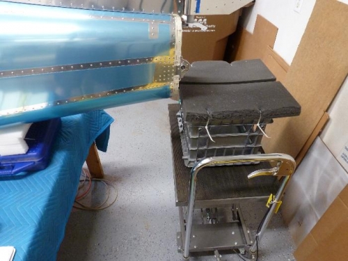

system to hold stab. for install
stabilator installed
remaining fairing attach holes
