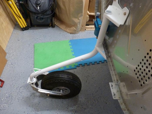

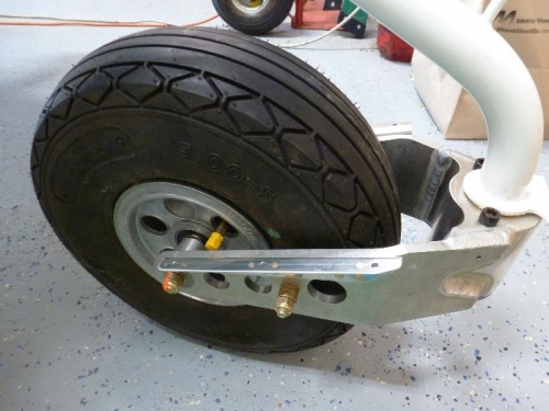

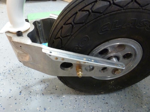

Brief Description:  Rivet rivnuts to nose wheel fairing brkt, install
Manual 36iS/U-08 steps 4-6 attach nose wheel fairing brackets to nose fork and rivet rivnuts.
Manual 35-08 steps 3, 5, 1, 4 bolt new nose wheel leg to fuselage and torque bolts to 30 in/lbs.install new fork onto gear leg, adjust the rotate pull force to 18 pounds with digital fish scale.
Manual 35-09 step 1 remount the nose wheel assembly onto the new fork, torqued to 204 in/lbs and apply torque seal
new fork on new leg
new fork on new leg
new leg and new fork installed
