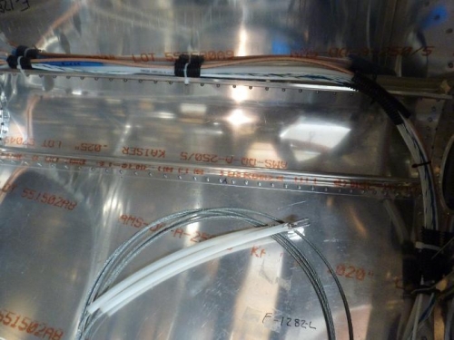

Brief Description:  clean wiring, routed wiring in tailcone
Re-torqued the 6 bolts holding the rudder peddles to 35 in/Lbs and applied torque seal. Tightened a little the wiring trough and applied torque seal but not torqued.

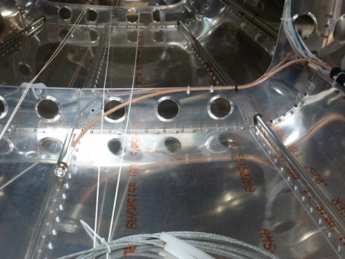

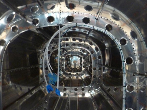

Manual 31B-20 complete step 5 and 31B-21 step 1 and step 5 - routed wires, cables and tubes (pitot and AOA) in and around the tailcone. Used some pieces of wire tubing at three spots on the side of the tailcone to protect them from the edges of the J-channel. Wiretied all of the bundles as required.
left side wiring in tailcone
wiring in tailcone
wiring in tailcone
antenna cable in tailcone
