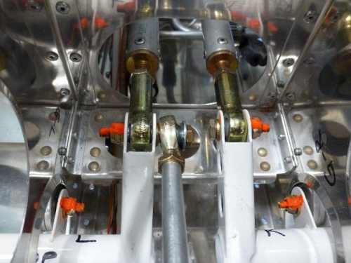

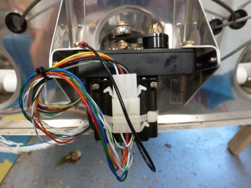

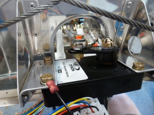

Brief Description:  Install roll servo
Manual 44A-03 steps 1 - 10 attach wiring sockets onto both servo wires, insert into the socket connectors. Install the servo, used Loctite 243 as the thread lock. Torqued to 30 in/lbs the bolts attached to the servo and the right side flaperon controls and applied torque seal. Could not torque the left side where the servo pushrod is attached due to clearance. Applied torque seal as a visual indication of solid nut.
