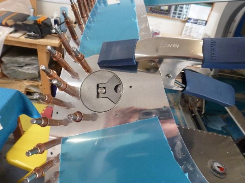

Date:  5-27-2020
Number of Hours:  2.75
Manual Reference:  37-07
Brief Description:  bend the fuel filler flange and drill for mounting
Manual 37-07 finish step 2 and complete steps 3 - 7. Bend filler neck flange for proper fit to the turtle deck. Clamp and match drill #30 holes into the flange. Removed the filler neck, used screws to hold nut plates and drilled #40 holes for nut plate mounting. Machine countersunk holes into the top of the filler neck flange for rivet mounting.
holes drilled into flange
