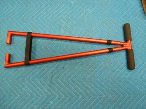

Assemble tow bar just received from Van's

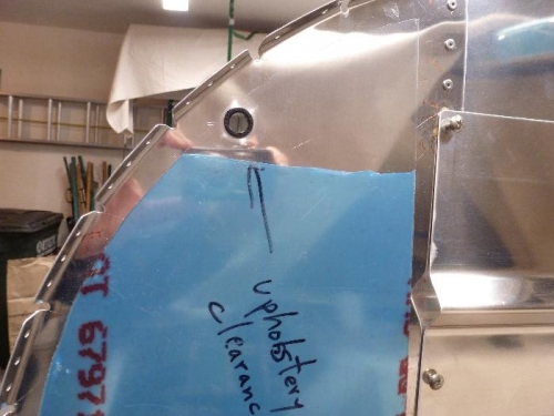

Manual 37B-03 figure 2, drill 1/2 hole in rear bulkhead for fuel vent line, insert grommet. Located per where the interior has a cutout not quite matching the dimensions on the plans.

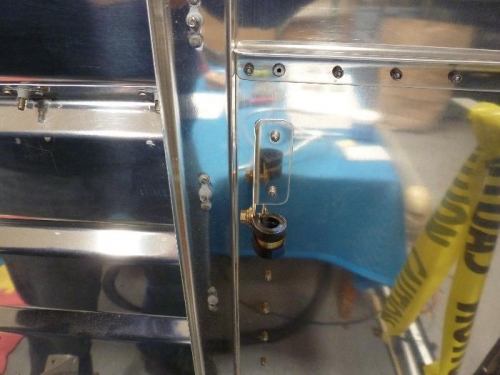

Manual 37-08 step 4, 5, 7 install vent line bracket and fabricate the fuel vent airline assembly. Start to bend the tube for one of the fuel vent line T-01219B.
Tow bar assembled
Tow bar assembled
fuel vent line bracket
fuel vent line hole/grommet
