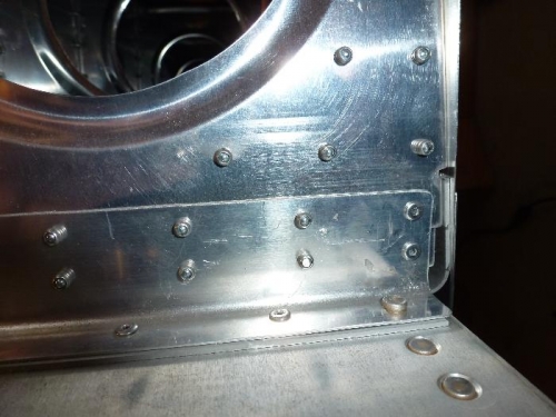

Notif. 16-12-14
finish AOA in left wing, other mods
Notification 16-12-14 step 20 fabricate AOA connection tube, step 37 replace left wing access plate.
Drill out two rivets and replace in different orientation on left wing at fuselage attach point to avoid interference with the fuselage when attached, filed two rivets slightly.
replaced rivets left wing
