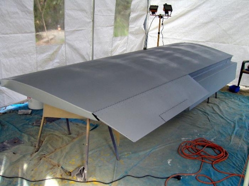

Brief Description:  Top of Left wing in etch primer and undercoat
I have changed the etch primer I have been using, probably should have done this at the beginning, but I guess I am yet to see how well this works. It’s very easy to apply and goes on in almost as light transparent coat with a green tinge. It has to over coated within 12 hours with a suitable primer, anyway enough said, after flying this afternoon, the top of the wing got a coat of 2 pack etch primer thus the open spray booth, followed by a single coat of undercoat. I wish the topcoat went on like the undercoat, boy is this stuff easy to spray, dries fast too. I'll re-read the instructions tomorrow and see how long the drying time actually is before flipping the wing over and repeating the process.
Outboard view wing in undercoat

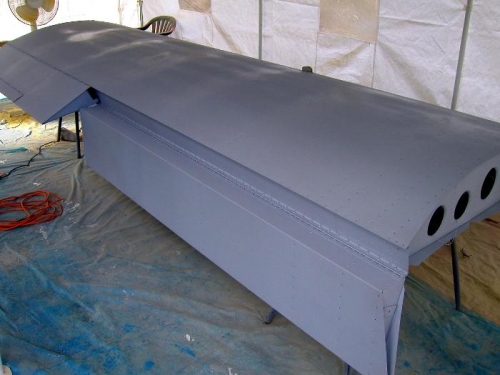

Inboard rear view
Inboard rear view

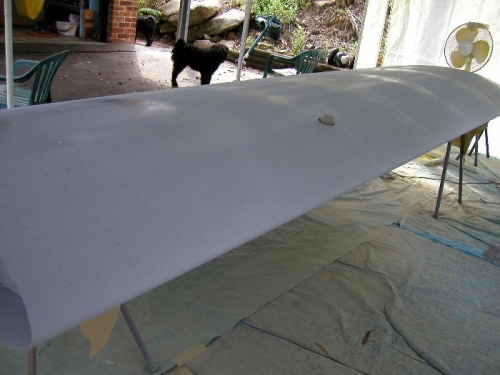

Front view, still some wet patches evident
