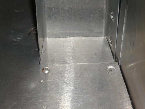

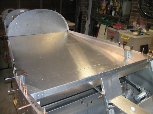

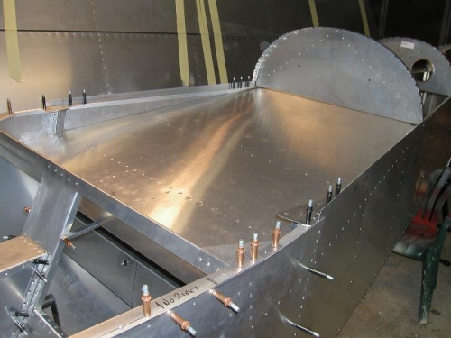

This evening I installed the baggage floor, to do this and be able to pop rivet the floor to the L angles that run down the fuselage sides, I removed the top length of extruded L angle, which gave me good access with the rivet gun. I also decided to make cover plates for the holes left when the cut out was made for the baggage floor to go around the C channel. This can be seen in image 3. With the baggage floor in place the fuselage has gained even more strength, its really starting to become a solid structure now. Tomorrow night I'll go back to the turtle deck installation and finish drilling the front hoop.
Right view, baggage floor pop riveted into place
Left view, baggage floor pop riveted into place
Cover plate for cut out in the baggage floor
