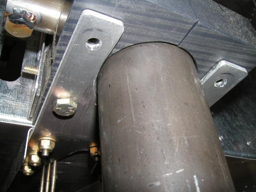

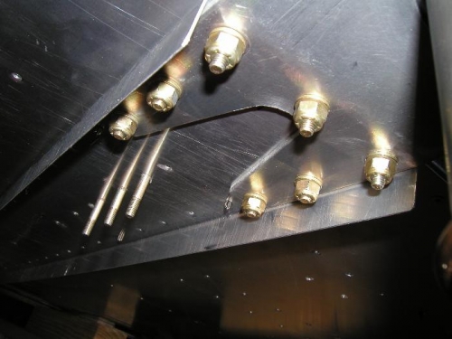

This evening I tapped the nose gear bush to take the 1/4 inch bolts, I borrowed the taps from Dusan and per his suggestion put them in the drill press and rotated it by hand, ver easy to control and I am pleased with the way they turned out. I also started making the cutout in the front seat panel where it butts up against the fuselage sides.
Bottom nose gear bracket bolted in place
Bottom nose gear bush, tapped to 1/4 NF
