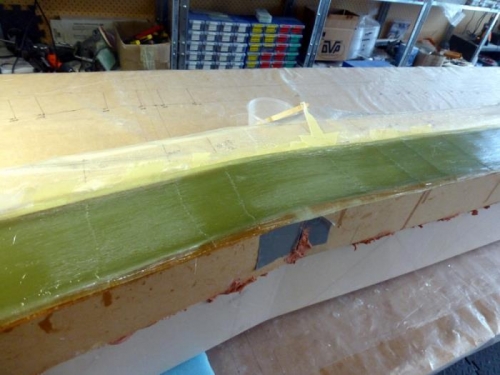

Brief Description:  CS Spar Top Cap layup 2

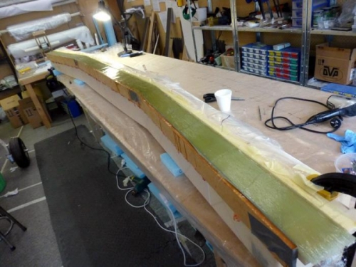

This page is to show you what the work looked like in the first 2 pics. Its not a 'difficult' layup in terms of complexity but it is a long one and with all this work it is maximum concentration.

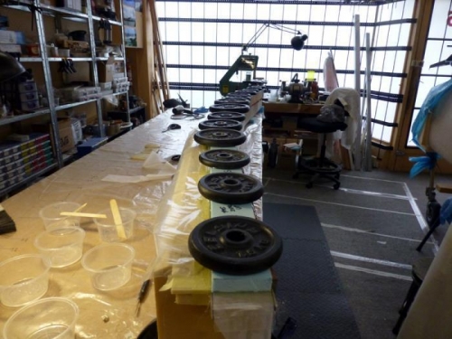

The last pic is after peel ply and some plastic and then soft foam in the troughs to distribute the weights on top.
Frankly many of the early layups must be nearly cured but its still worth being tidy and doinmg the weights thing.
