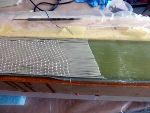

The first pic is to show you the cross threads. Once the cloth is down a key thread is taken out all along one edge which releases the cross threads. These you can see being removed in Pic 2. Once they are out the fibres can be layed up flat but there are also 'free' so it can get wild if you are not in control.

Cross threads need removal
