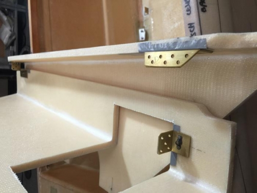

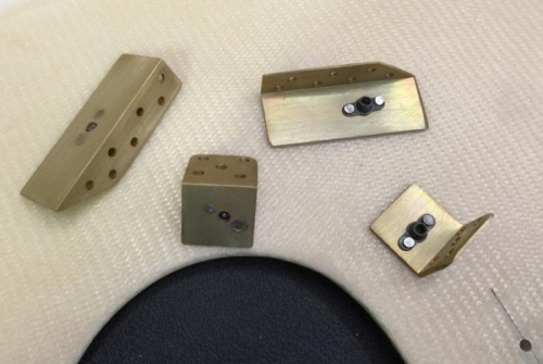

Now for the top securing screws for this front console. I soon found that my prepared 1 x 1" mounts were too wide for the rear support due to the window indent position. It needed a shorter leg to fit. I made up a set with a longer base so the gluing area was retained. Such a small detail that took a few hours to sort out.
With the parts made, I then alodyned them and once dry added the nut plates. Lots of release tape and then the flox to secure these to the fuselage wall. This time I could use screws on the three bottom holes while the wet flox was used for the two top pieces on each side.

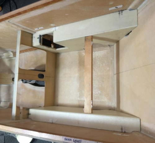

Pic 3 shows I've added a 'clamp' to ensure the consoles sit flush in position while curing.

Removable console hardware is K1000-8 nutplates, MS24693-S52 countersunk machine screws and 1.7mm aluminium brackets which were alodyned and floxed in place.
More parts
More parts
Release tape
Release tape
Improvised clamping
Improvised clamping
