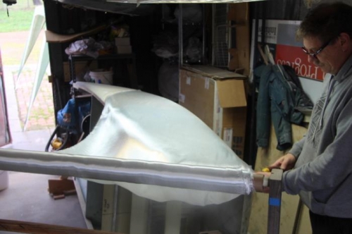

Cut all remaining cloth and top plastic.

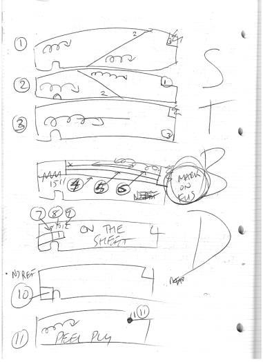

The diagram is how I plan the layup. I had problems in the past where I cut all the cloth to fit, but because it isn't oriented correctly doesn't fit. Or I get it backwards, etc. Bit like the Oirishman that finds a really good fishing spot, so puts a mark on the side of the boat so he can find it again... This way I have a mark on the exposed end of the rolled-up cloth which I can line up with a feature on the aeroplane, and I mark it on the diagram so I don't forget. All the cloth is stacked so the next layer is topmost, and the reference mark is a number so I can check if the layup schedule is going as planned.

cutting, cutting
cutting, cutting
Method for orienting the bits.
