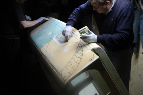

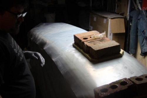

Glassed STBD side. 2 x UNI @ 30 degrees, 1 x UNI longitudinally and various UNI reinforcements. Peel ply the lot, then notice I've omitted the 2 x BID at the rear. Curses! Too tired now, do it last when I trim the rest.
Noticed some drips going into the fuselage, layed down some drop cloths.
I flox the window edge, Grant slaps on the micro

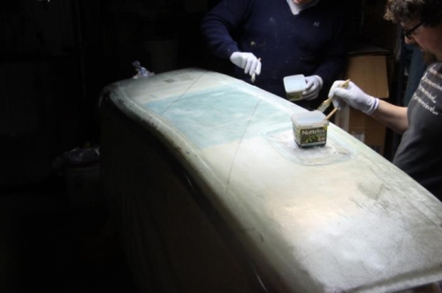

Upper reinforcements
