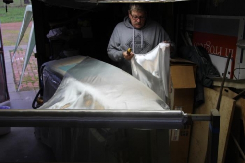

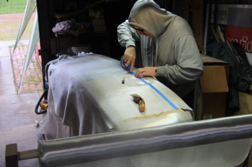

Glassing the sides. Preparation
Cut all the cloth for STBD side, UNI edges taped, other than the selvage.
Tape and cut the UNI
UNI @ 30 degrees
