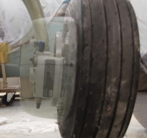

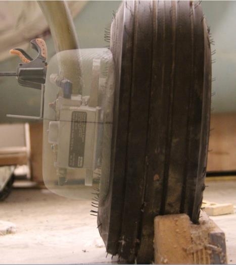

Using the ghost picture as a guide, keep trimming the cover, aiming to get the inside face 11mm from the axle clamping plate.
Decide I want enough clearance above the rotor to have a heatshield, so cut a slot for the rotor to protrude throught bottom of the fairing about 4mm. In short, the part could still have been larger, but I'm happy to persist with the current part.
Fart around for a while trying to bend up a bracket to attach this thing to, attached to the axle bolts. Eventually decide I should stick to what I know, and make a form to make a composite bracket, tape it up and make a 5 x BID layup within.
First cut, still plenty of clearance
Final profile, still some trimming on the tyre side needed
