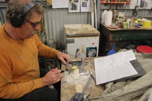

Trimmed brackets, they look loverly.
Jacked up the port side at the spar tip, pulled off the main wheel, and installed the bracket with AN960-416L washers. I was worried they would be squashed by the standard torque, so torqued them up to 60 in/lb, and they look fine. My torque wrench is out of calibration, but final torque will come later.
Ran some strip LED through the bracket and re-fitted the cover, and marked the bracket location. I fitted 2 x K-1000-3 nutplates. [Timewarp next week: eventually decided 2 mounting screws was over kill, so just went with the forward one]

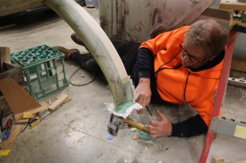

Installed the cover, with the top secured with a hot glue block. Made a template that makes a profile for the mounting bracket outside the main strut that clears the brake rotor. Removed the wheel, and made a crazy arrangement of hot glued bits of wood covered with modelling clay, with 1.5mm packing pieces where this bracket will meet the cover.
Placed a bit of paper as a release over the cover, and packed modelling clay in up to where the gear fairing stops, and shaped to a pleasing profile, parallel to the brake rotor.
Removed the cover, removed the packing pieces and layed up 4 x BID, overlapping 1" onto the mail landing gear strut. I extended 2 x BID over the modelling clay to overlap the strut and gear fairing by 1", and peel plied the edges.
