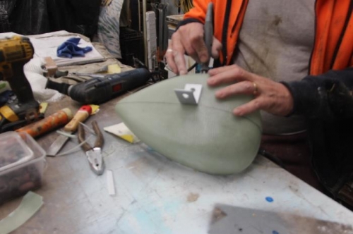

I mark the centerline of the part, hot glue on a steel bracket for a level, and rough out a hole for the main landing gear strut.

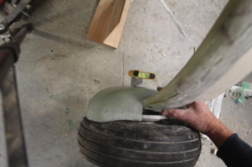

Offer it up, and start trimming the edge agains the tyre. Make a ghost picture to see how close I am getting to the caliper and other hardware.
Profiling a hole for the gear leg
Mmmmmmm. I think it is working

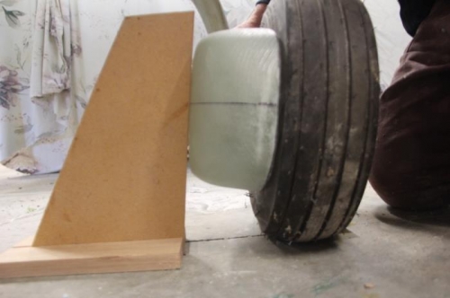

Trying to parallel the wheel.
