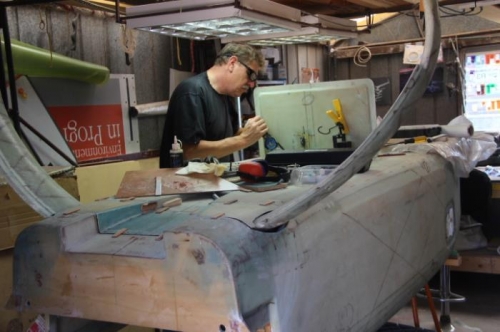

Torqueing up the hinge bolts

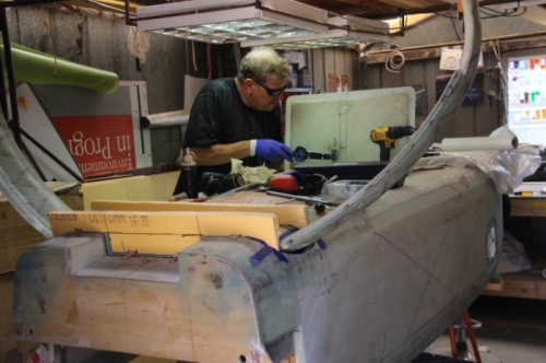

Installing Actuator Bracket

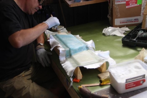

1st layer BID, over the tapes
