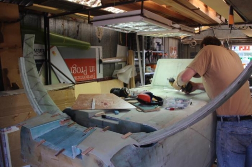

Just need to round the edges

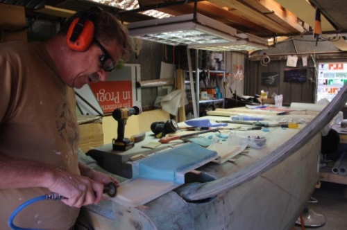

Drilling through hinge and Landing Brake

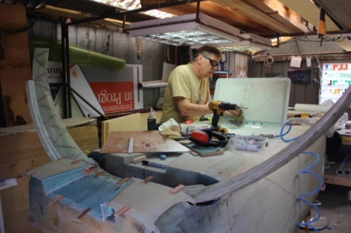

Juggling clecos and screws and nuts
