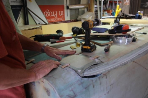

Trimmed MLG Outer Cover, looks good, but slightly warped, guess my jig should have been flatter on the bottom.

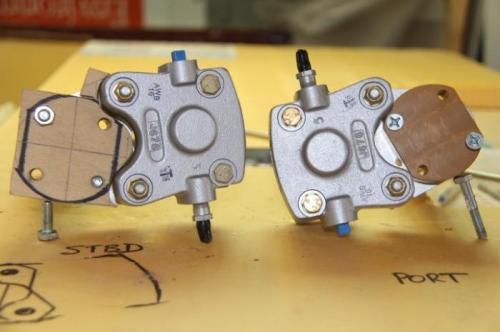

Used ply template to predict Strut cut line and clearance between Axle Flange and Caliper. There is less than the required 1/6" clearance, and interference in some areas. Was really surprised to discover I couldn't just invert the template and do the other side, eash side's cutline is DIFFERENT! WTF!! Doesn't seem to be caliper specific, something is assymetric I suspect.
Nothing about it in the plans, my notes, and (as they are incorporated in my notes) the FAQ. Hmmmmm. Internet time.

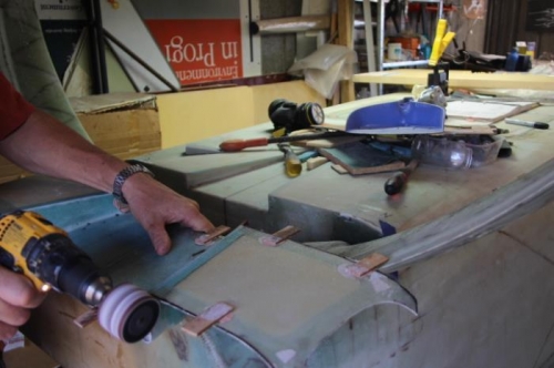

Trimming, trimming
Trimming, trimming
Still a bit tight, but the alignment sticks get in the way
Axle/Caliper clearance issue
