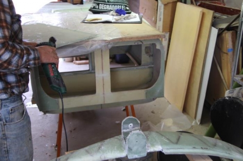

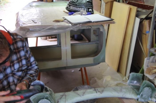

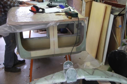

Took one look at LB Fus cutout and despaired. Lots of air under the layup, lots of excess resin around where the plastic touched it. Horrible. Inner surface of LB is OK. I put it in the cutout, and will confront when the MLG Strut is complete.
Trimmed MLG Attach Tabs. Top layer is a bit dry in the corners, had some resin leaching into the clamping boards. Drilling through the pilot holes delaminated the not fully cured inner tabs. Delam area is smaller than the eventual holes, but all a bit disheartening. Got a bit pissed last night, and regrets are everywhere...
Placed strut in fuselage for trial fit. Not successful, Despite jigs pilot holes are not square to face of tabs, total error about 1/4", and not sure where the error lies. All in all a shit day. :(
