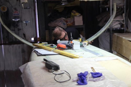

Brief Description:  Aligning MLG Strut with Fuselage
File a bit, replace strut, check alignment, figger out where to file next, remove strut, file a bit, repeat. It seems endless, but eventually the MLG Strut is aligned reasonably, the 1/4" steel rods go all the way through.
Strut is twisted a bit it seems, and I can't get the alignment any better than 1/4" FWD PORT side, and 1/4" AFT STBD side, at the forward ends of the strut. It is at least dead-nuts level. Suspect rods are bending a bit as they go though, indicating alignment is not yet perfect. Concerned I may make the holes too big to be a guide for drilling.
Will have another look tomorrow.
