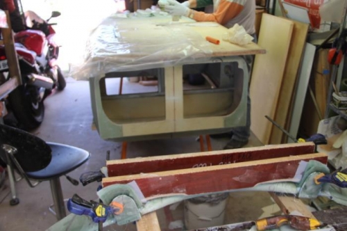

Prepped strut for inner Tab layups, filled pilot hole with wax.
Rejigged clamping boards to fit inside Tabs and re-taped.
Layed up MLG Tab inner tabs, same as the outer.
Layed up LB fuselage cutout and inner surface LB.
[Timewarp 26/01/15: Too much, did a crap job on the fuselage, can barely look at it, will have to sand most of it off. Need some thin plastic and more foam to follow this complex a shape. Was too tired to do it properly. Decide to follow the plans in future and do it step by step instead of two different steps at a time.]

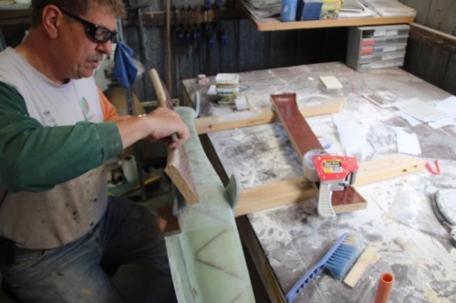

Adjusting clamping boards to fit on the inside
