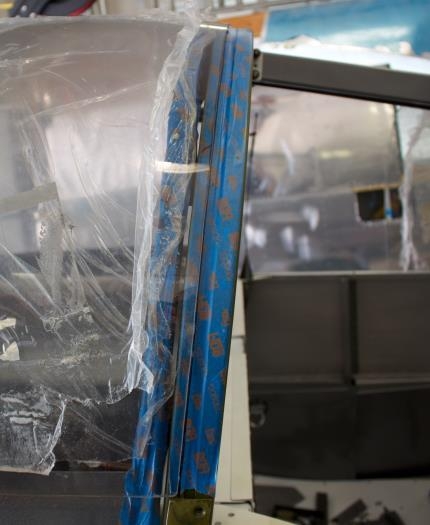

Deburred the cut line edges on front and rear canopy pieces. Recall earlier when I noted the big canopy stood proud of the middle roll bar by about 3/16" before the big cut. I pressed it down when electric taping the cut line. After the actual cut, for about 1 foot across the middle of the rollbar top, the cut canopy did lay down, but the cut line is maybe 1/32 too far aft. So I will be sanding it with a long sanding board until it matches the roll bar cutting line exactly. The rear window eventual cut line will be hand sanded to final position as well so we will have a beautiful matching pair of final edges.

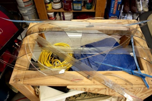

There it is. All the cuts and waste.  I'll practice drilling on them.

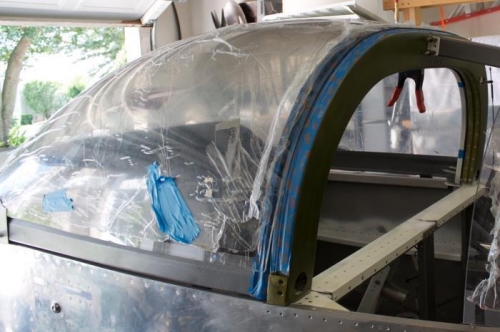

Forward canopy lays perfect.  I'm so happy.
Side view of the marked roll bar line and cut line. Sand the top middle edge 1/32.
