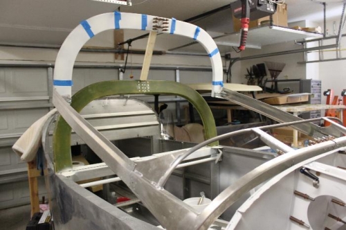

Manual Reference:  Drilled F631A
Brief Description:  Canopy Frame 8
Drilled the rear canopy bow (F631A) to the canopy frame side rails. For starters I drilled it #40 just in case slight adjustments are necessary. I think I got it ok, but you never know. I will remove the frame after fitting the top forward skins for the 1st time.
Tip up tipped up.  Still sort of flimsy so must be careful.
