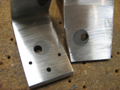

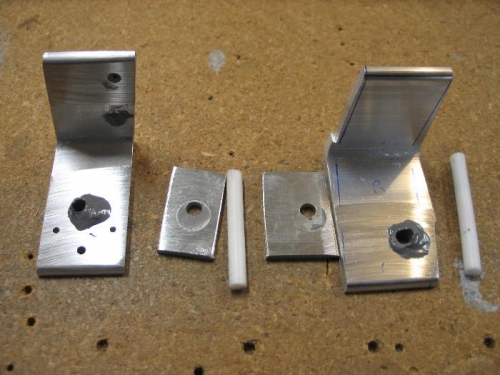

Brief Description:  Hole Fixing - Extract rod and sand shape.
The Teflon rod came out very nicely. Didn’t stick at all. Separated the 2 halves. This stuff is really hard.
Belt sanded the extra away. Looks like a nice fix to me. These are just test pieces. These will not be used on the airplane.
So, which product is better. Can't tell the difference in the end but the Devcon has 16 hour cure time and the Fast Alum cures in only 2 hours.
Pull Teflon, separate 2 halves.
Sanded finished fix.
