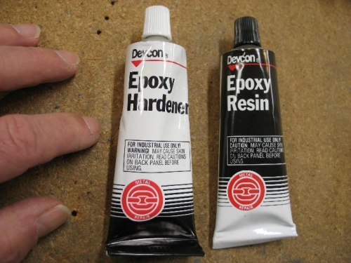

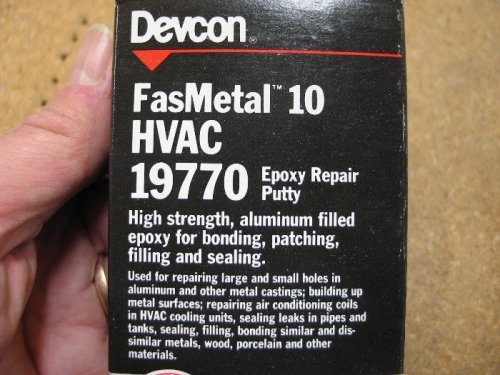

Brief Description:  Hole Fixing - Devcon Fast Epoxy.
Got this from McMaster Carr.
Its Aluminum Epoxy Repair Putty made by Devcon. Good for fixing enlarged holes or moving holes in aluminum.
Its mixed 1 to 1. That sure makes it easy to mix. Working time of a couple hours and cured in 16 hours.
Can be milled or taped.
Devcon Epoxy Repair Putty.
Mixed 1 to 1.
Mixed 1 to 1.
