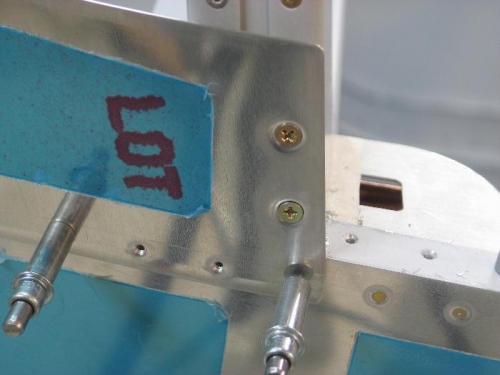

Roll Bar - Drill roll bar to fuselage. Part 5.
Here we drilled the forward holes from #30 up to #21 and then taped it for 8-32.
I only have 3 threads in the 631C/D angle. Hope that’s enough. If not I’ll put a nut on the inside.
Drill to #21, Tap to 8-32.
