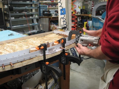

Brief Description:  Roll Bar - Rivet forward side of roll bar.
Oh boy, I get to rivet something. Haven’t driven a rivet in a while.

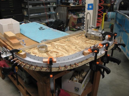

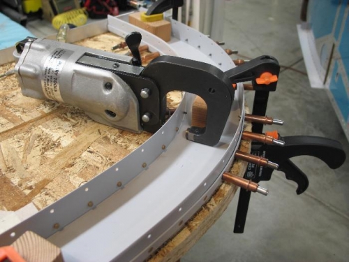

Started in the center and worked my way out. Image 2 shows how I riveted the inner rivets. What you can’t see is that the roll bar is sitting on ¼” strips to elevated it a bit. This helped get the rivet squeezer at the right angle. Easy riveting.
Clamped for riveting.
Squeeze inner rivets.
Squeeze outer rivets.
