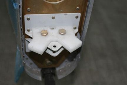

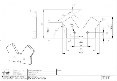

I priced the material at Mcmaster Carr and I can get 5 feet of this stuff for less then $3.00. Don't know what shipping is yet. I almost bought one of Craig's but at the last moment I thought "Hey, I'm an airplane builder. I'll make my own". When I'm showing off my alternative rudder stop I'll be able to say "I made it myself, it's a Craig Vincent design".
Thanks Craig
Craig Vincent Plans.
Craig's Installed on rudder hinge.
Craig's in action. Looks good to me.
