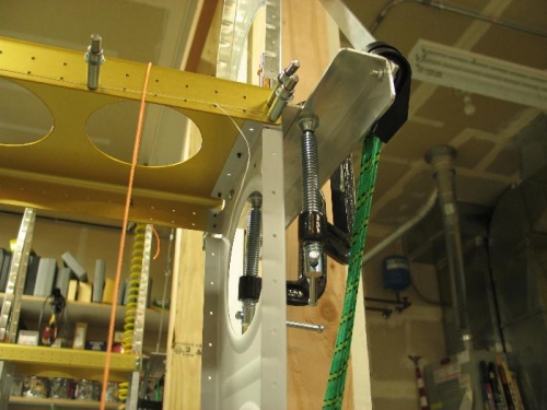

3 pictures showing the wing jig support for the out board main spar. I used bungee cords to pull the horizontal angle bracket when adjustments are made on the upper support turn buckle. Leveling out the horizontal support without the bungee is difficult.
