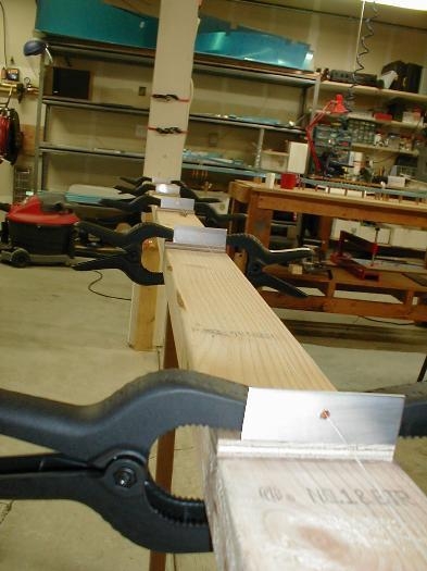

Brief Description: Horizontal Stabalizer work jig.
Here is the horizontal stabilizer jig. The 5 angle brackets are custom made from aluminum angle stock from Home Depot. The holes in the brackets will align with the elevator hinges. Notice the piece of dental floss going through the holes to help achieve perfect alignment.
