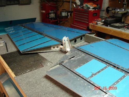

Brief Description:  Fitted Left Elevator
I completed the leading edge of left elevator...

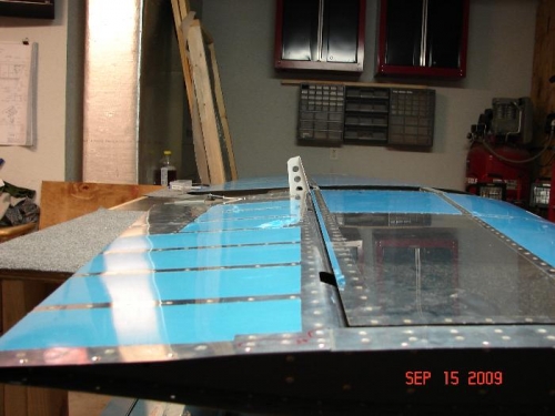

I continued to fit the left elevator to the horizontal stabilizer.
I installed the rod bearings and adjusted to the 13/16 - 7/8.
Installed the elevator with the required AN3-7A bolt.
Everything lined up nicely. I fabricated a bushing to protect the bearing and drilled #40 pilot hole through the elevator control horn.

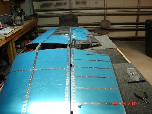

I then installed the right elevator and checked for consistency and alignment. It really looks good.
The control horns line up prefectly, and cleanances and trailing edges of both elevators are even.

Left and Right Elevator
Elevator Control Horns Match Drilled
Alignment Looks Great...
