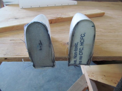

I started off finishing the fit of the left horizontal stab tip. Once happy with that I laid up 2 layers of BID cloth to both tips and left them to cure.
