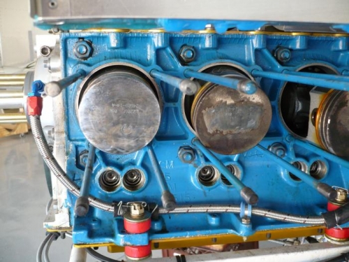

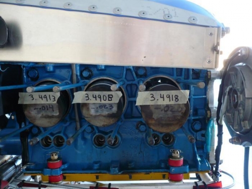

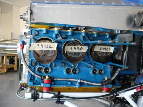

De-ring and measure pistons
Average piston size is 3.491666667
With low of 3.4908 and high of 3.4922.
The rings came off cleanly from all pistons. One #3 was a little sticky but not bad at all.
Began cleaning the carbon off the pistons.
