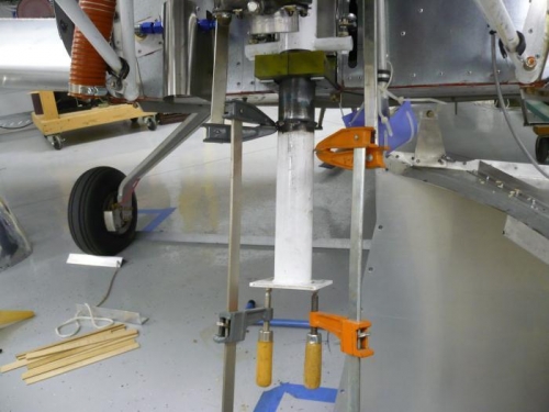

Brief Description:  Installing the nose gear shock cord 2 of 3

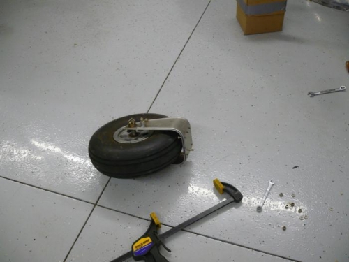

The wheel had to come off to get things started, needed some place to clamp the clamps. The cross tube just fit above the fork from the bottom of the fuselage, bungee is in place and loose.

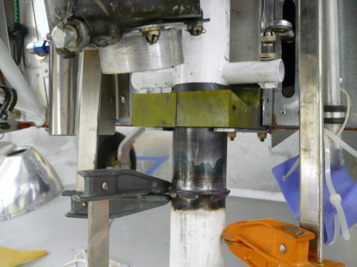

The it was just a matter of tightening up the clamps. Had to reset a couple of times but one set of clamps held the tension so the other clamp could be reset to have more travel.
Once the green blocks fit in, they got bolted in place.
