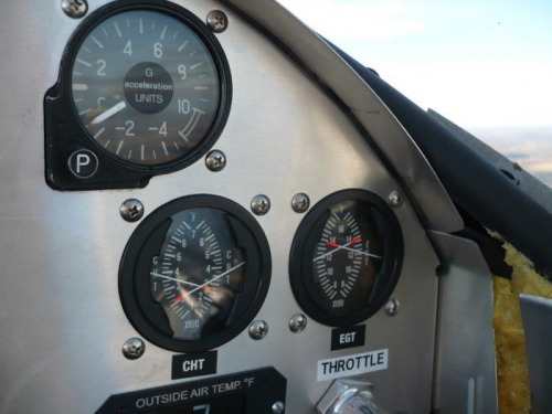

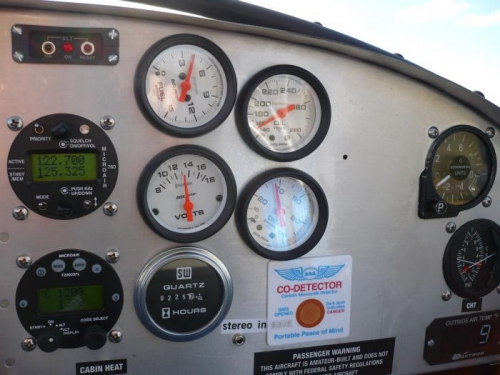

Started engine with 100LL and let it warm up till oil was 150 degrees.
Temps at full static run up
CHT 320
EGT 1400
RPM 2700
OT 150
OAT 38F

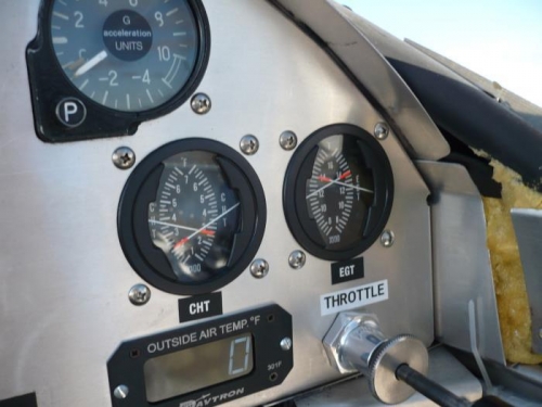

Took it up flying then switched tanks to the right tank which has 10 gallons of 93 MOGAS with 10 percent Ethanol. After running it 5 minutes on the same heading as the 100LL the temps, both CHT and EGT ran cooler.
Warming oil up
Warming oil up
93 MOGAS 10% Ethanol
