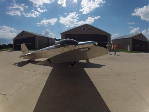

Set this test to see if everything is safe for flight. This is the attitude my first flight takeoff will be, it's about 10 degrees on the instruments.
The test is run for two minutes wide open throttle to represent climb attitude to make sure it can do it. If this passes the same test in the air will take the airplane up to around 2000' AGL.
Tie down chained to the earth

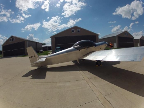

Mains chocked
Mains chocked

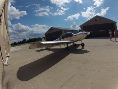

Nose wheel blocked up
