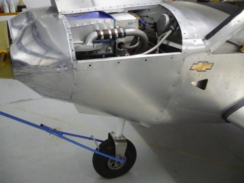

Brief Description:  Back in the air
After tuning up the valve seats via hand lapping, the engine was started again today and seems to be running well. Modified the air inlet ( now 4.7" ) and outlet flange extended 30mm. Flew 1 hour today to seat the rings and the ambient temp was 55f, oil temp never got over 220. CHT below 300 all realms, 250-280 in crusie.
Might still have an oil leak up front.
